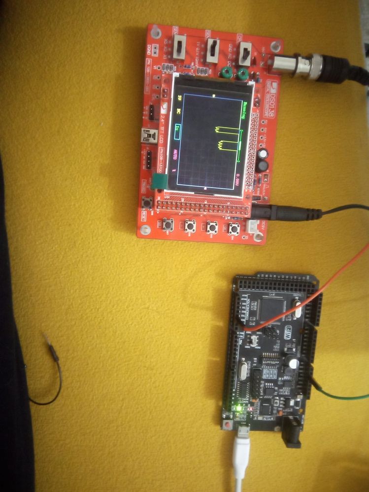

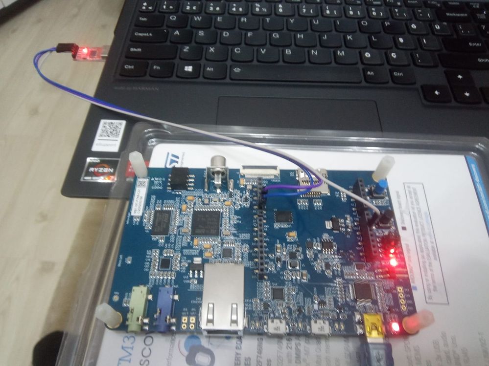

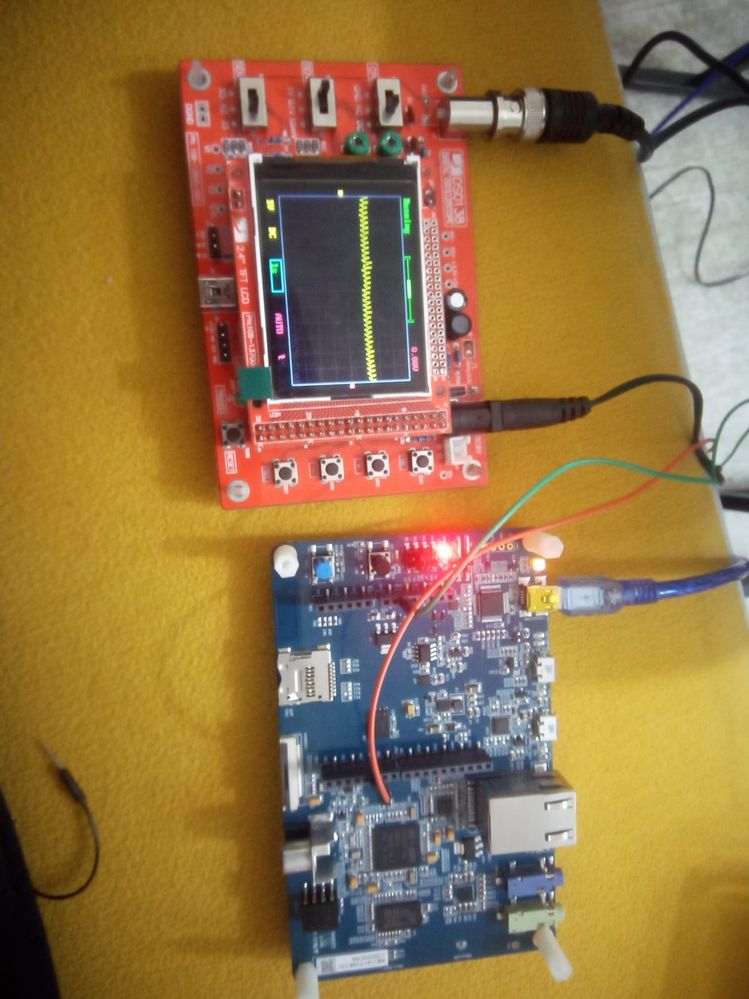

Seems you have converter, but scope ?
2021-01-03 8:51 AM
Arduino:
STM:

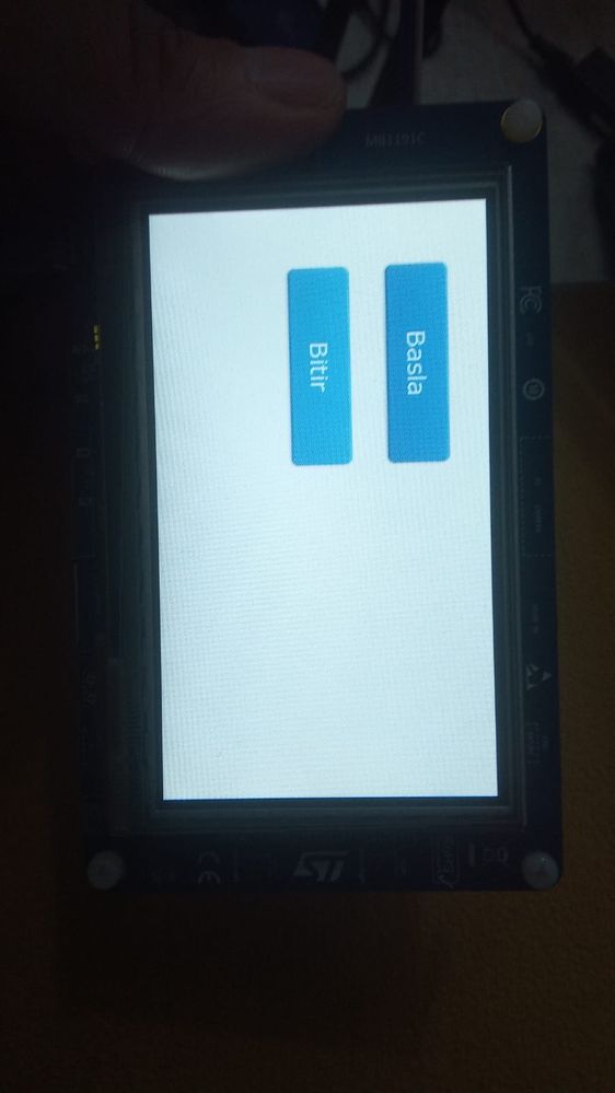

2021-01-03 9:09 AM
Maybe i dont understand your photo, but where you have touchGFX display and where you click ?
2021-01-03 9:17 AM
I click Basla Button.
