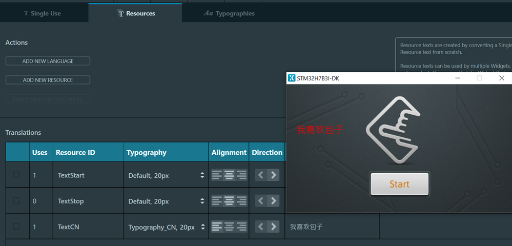

Can you try to add another text area where you just display the chinese text ? I tested on my side and was able to display without any issue with your font with the simulator and on a board I have. I put the text i wanted to display (我喜欢包�?) directly in the "Ressources" tab and did not have to put anything in the wildcard range. I believe the issue might come more from your code and what you are trying to display.

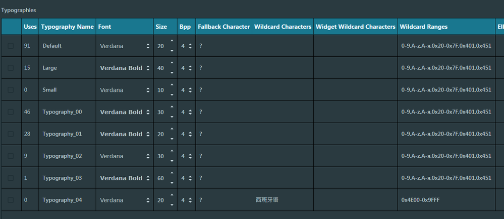

2021-01-04 6:56 PM
Hello EEuge,
To add a range of Chinese characters, you need to add the range using the Unicode values from 0x4E00 to 0x9FFF for all Chinese characters.
Of course this range is very big and will probably not fit your memory so you should select only the ones you need.
Instead of writing a range, you can also enumerate the characters in the Wildcard characters field.
/Alexandre
2021-01-04 10:52 PM
Typography04 -I use it for Chinese language.
Not works.... And first sign of it - no code size increase

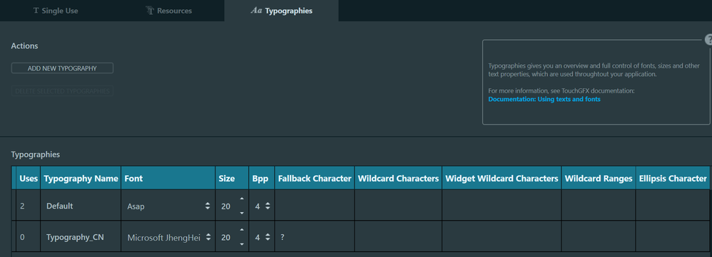

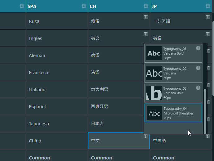

2021-01-05 1:45 AM
Hmm...
I set range in Typography_04
I Install font "Microsoft JhengHei"
I set Typography_04 to China language
Good!
I see ".cpp" files of fonts in my project
Compiled code size increased from 7MB to 11MB, I decide to put it to QSPI
