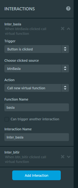

2021-01-03 3:15 AM
Hello
Thank you for replies.

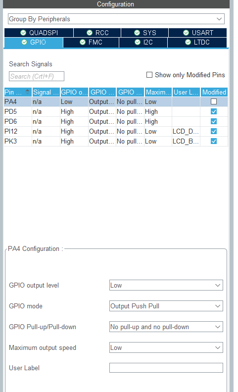

I created new project and added two button with two interaction.
I set uart2 D5 and D6 pins.115200 baud and polling connecting not IT or DMA.
I coded like you but same result . i cant send data from stm32746 to pc via uart.

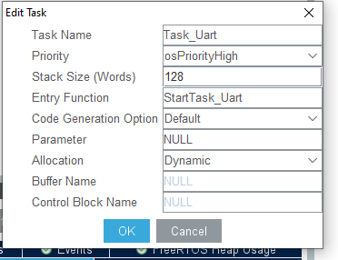

}uart task i created in main.c
/* USER CODE END Header_StartTask_Uart */
void StartTask_Uart(void const * argument)
/* USER CODE BEGIN StartTask_Uart */
/* Infinite loop */
for(;;)
if (giden[0] != 0) {//icinde deger varsa
HAL_UART_Transmit(&huart2, (uint8_t *)giden, 10 ,30);
giden[0] = 0;
osDelay(1000);
/* USER CODE END StartTask_Uart */

void Screen1View::basla()
strcpy(giden, "basla\n\r");
btnBasla.invalidate();
void Screen1View::bitir()
if (giden[0] == 0) {
strcpy(giden, "durdu\n\r");
btn_bitir.invalidate();
}We’re moving the ST Community to a new platform to give you a better and more reliable community experience.
