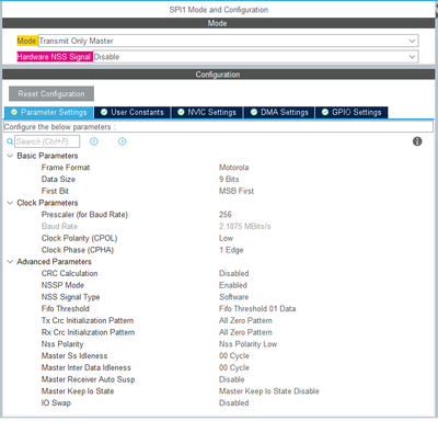

Thanks for your reply and code. In the code is not present the SPI mode initialization, can you clarify if is 9 bit or 16 bits? I adopted the gpiospi type, but no fortune for me. My interface not start in every mode possible. My display is 800x480 in horizontal position. Thanks for your help.
2023-08-16 4:17 AM
It's 9 bit.
