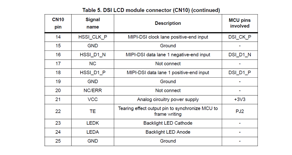

The tearing effect is an effect similar to judder.
It is the pin 22 of the LCD module connector CN10 (TE), since the
STM32F469BIT6 (TQFP176 ) does not have PJ2, I need to move it to another port and I need to change the pin in the software!
