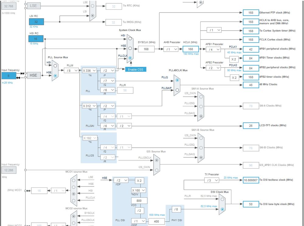

Now i want to use the USB Port, which needs 48Mhz.
For that i had to change the SYSCLK to 168 which was 180 Mhz originally.
Everything works still fine, but when i do a fade-in of a picture, it flickers.
Then i was looking to the Datasheet of the SDRAM N25Q128A and on some other websites i found that this may be a problem of the dummy cycles which needs to be changed.
APB1 was 90Mhz with 180 Sysclk and now i have 84Mhz.

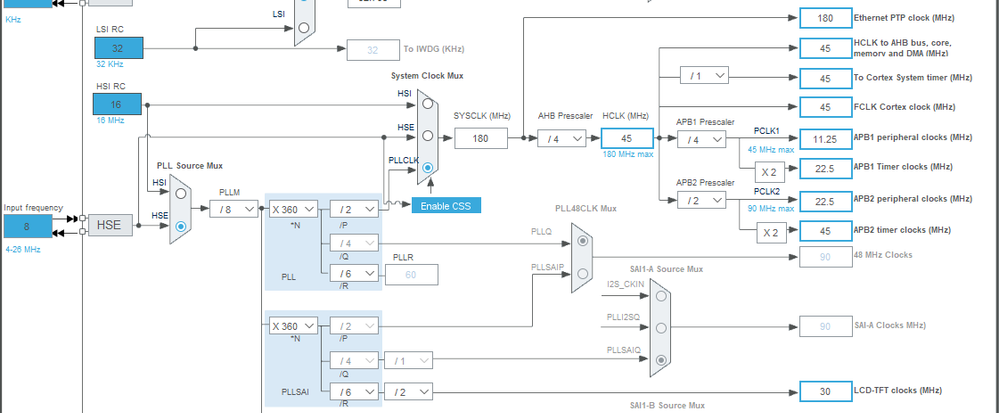

FYI, I left my SYSCLK at 180 MHz, and lowered my HCLK to 45 MHz using the AHB1 Prescaler, and my fades don't flicker (but I'm not doing any full-screen fades). Not using the PLL48CLK, though.
Fades are very processor-intensive - do you have the same flickering with smaller pictures?

Yes, on 180 MHz i do not have any problems. But i need to activate the USB and this needs 168 MHz, so the only way to get that is this setup:
I tested fullscreen fades and smaller ones. On smaller ones the whole screen got some "flickers" during the fade. Wipe transitions are ok.

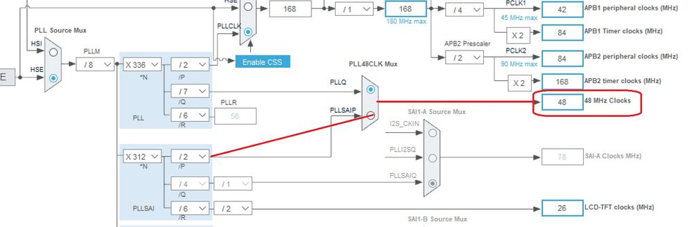

If LCD_TFT clock could be lowered somewhat to 24MHz (I don't know what are the ramifications of this), 48MHz USB clock could be generated in PLLSAI, while retaining the 180MHz sysclk generated in "main" PLL.
2022-04-13 6:53 AM
Can't you generate the 48 MHz clocks via the PLLSAI ?
Slow down the QSPI bus clock
hqspi.Init.ClockPrescaler = 1; // Make BIGGER, ie 2

Yes, my point was only that all of my clocks driven off of HCLK are much slower than yours, and I have no issues with the display. My LCD-TFT clock was unchanged, at 30MHz, from using PLLSAI. I agree with others, definitely worth trying to get 48MHz from that.

Unfortunately my display works only perfect with 26MHz, i already tested for hours to play with the values of the display to get it working without strange behavior but i had no success.
But what are you guys thinking when everything works good with 180 MHz and with 168 MHz the display has problems only with stuff like fade-in functions.
Other movements like wipe/swipe (except slide transition, there i still have a lot of problems with a clear picture but not important now) work perfectly.
Changing from 180 to 168 MHz and some flickers at the screen during fade-in should be something wrong with the external memory (framebuffer) ?
