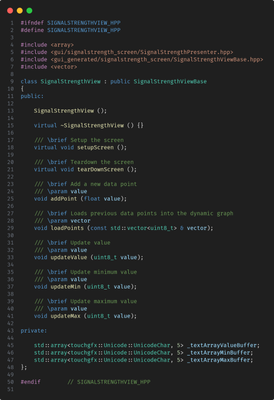

Consider an editor too: here's an example of what it looks like in VSCode:
2024-05-05 7:53 AM
