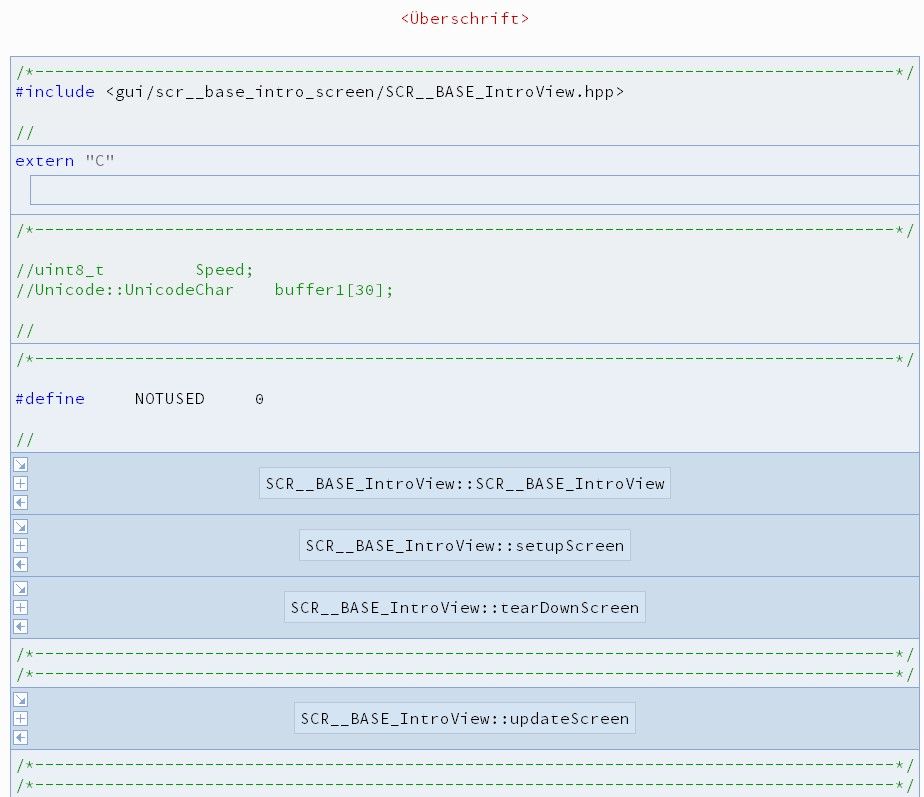

2024-05-04 4:38 AM
Thanks again to everyone who has tried to help me.
Unfortunately, all the help is related to my examples and not to my actual question about the possibility of customizing the code generator.
Here is a very simple example of what I would like to have:

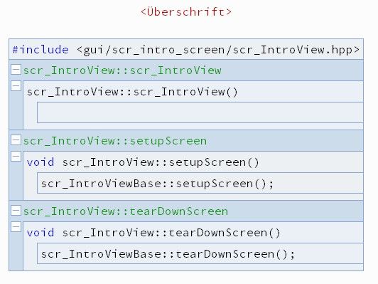

This is how the code is currently generated:
#include <gui/scr_intro_screen/scr_IntroView.hpp>
scr_IntroView::scr_IntroView()
void scr_IntroView::setupScreen()
scr_IntroViewBase::setupScreen();
void scr_IntroView::tearDownScreen()
scr_IntroViewBase::tearDownScreen();
This is how I would like the code to be generated:
#include <gui/scr__base_intro_screen/SCR__BASE_IntroView.hpp>

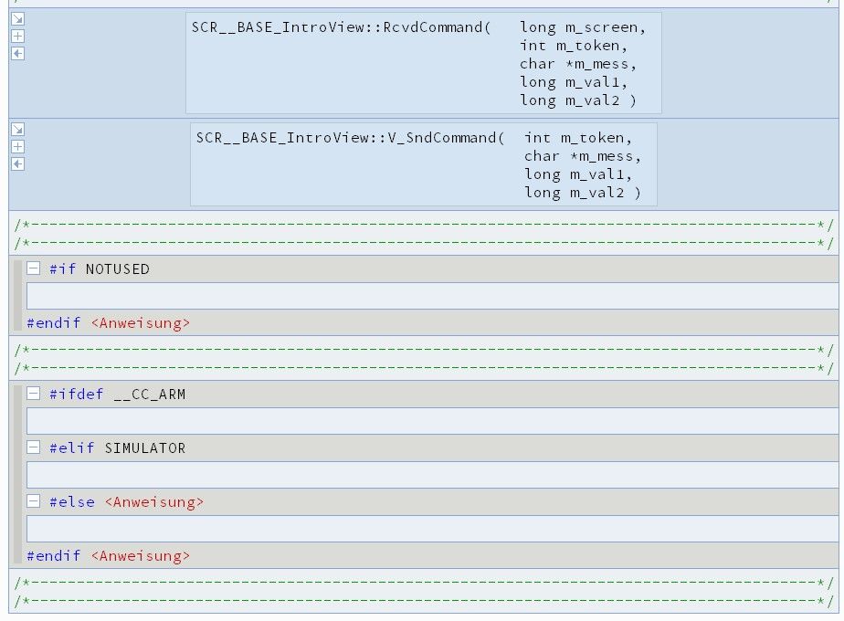

void SCR__BASE_IntroView::RcvdCommand(long m_screen, int m_token, char *m_mess, long m_val1, long m_val2 )
/* Aus _Screens.h die defines fuer die Screen-ID und die Befehle (token) die */
/* dieser Screeen kennt. */
//#define SCR_ALLE 1000
//#define TOKEN_SCR__ALLE_ACTTIME 1000
//#define SCR__START 2000
//#define TOKEN_SCR__START_RUNSTART 1000
//static int dummy = 0;
switch ( m_screen )
case SCR__ALLE :
switch ( m_token )
case TOKEN_UPDATE_SCREEN :
SCR__BASE_IntroView::updateScreen();
break;
default:
break;
break;
case SCR__BASE_Intro :
switch ( m_token )
break;
default:
break;
break;
default:
break;
void SCR__BASE_IntroView::V_SndCommand( int m_token, char *m_mess, long m_val1, long m_val2 )
//char mcmd[30]; /* */
//https://www.youtube.com/watch?v=SYdyJBehcYY
presenter->P_SndCommand( m_token, m_mess, 0, 0 );
#if NOTUSED
#endif
#ifdef __CC_ARM
#elif SIMULATOR
#else
#endif
/*--------------------------------------------------------------------------------------*/And yes, the V_SndCommand() function belong in “FrontApplication.cpp”.

Oh yes, and this is what it looks like in my favorite editor:
Generated:
wish:
(I also like to call myself a “formatting fetishist”)
Translated with DeepL.com (free version)
