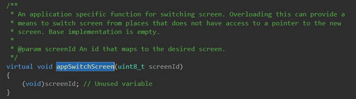

appSwitchScreen ()EDIT: actually GotoScreen () are also avaialble 'from any application code' via access to Application () instance.

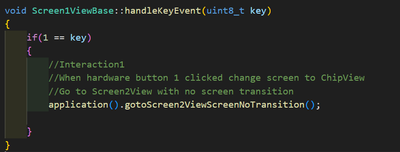

If you want to change screen in code, you need to generate the functions for it.
If you create 2 screens and you add an interaction to switch from screen1 to screen2, TouchGFX Generator will generate the function for that in the screen1 cpp base file:
Then, you can call that function yourself.
But you need to know which screen you are in right now to be able to call the correct function with something like:
application().gotoScreen2ScreenNoTransition();

there is
application().appSwitchScreen ( screenId );in \touchgfx\framework\include\touchgfx\Application.hpp
This approach assumes that GoToYourScreen () is/are already present.
