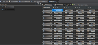

For reference, TouchGFX Designer version 4.25.0, CubeIDE version 1.18.1, and CubeMX version 6.14.0 are currently in use. The attached photo is a screenshot of the memory view taken during debugging. It appears that the values are not being read correctly.
I set the start address to 0xD0000000 using SDRAM bank 2. Is this correct?

Hello @newbiee and welcome to the community!
Have you seen this guide : https://support.touchgfx.com/docs/development/board-bring-up/how-to/04-enable-external-ram
If you say that SDRAM is not initialized properly, you should try to fix it.
One more thing you could do it to not use it at all in your project to check if it was the issue.

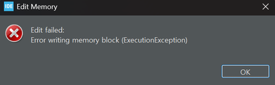

Oh, and I tried to modify the value in the memory view, but an error occurred as shown in the attached photo.

2025-07-02 9:14 AM
Write test code independently of TouchGFX
Test the SDRAM, perhaps make a "MEMTEST" type application walking patterns in the memory to prove it all works, retains, and is addressable.
