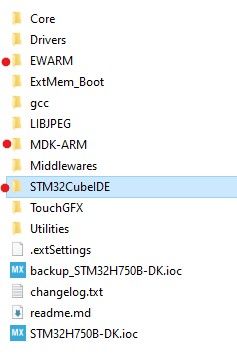

Hello @markd ,
Yes, you can easily apply your modification to the main.c file and generate the project. You just need to open the STM32CubeIDE project that is available at the folder with the same name which is created by TouchGFX. You can also open the main project in Keil μVision or IAR Embedded Workbench.
Available projects
I hope this helps you, don't hesitate to ask more questions

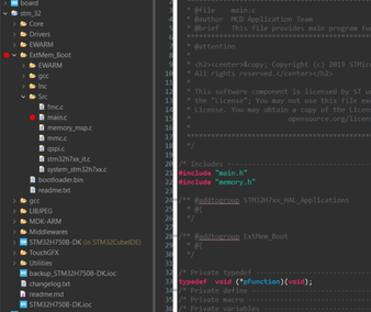

Hello @Mohammad MORADI ESFAHANIASL
Thank you for your reply, I actually want to build the bootloader program which is located in the ExtMem_Boot, while being the in the same project. I attached an image below.
You may have answered it already, I have some trouble understanding it.

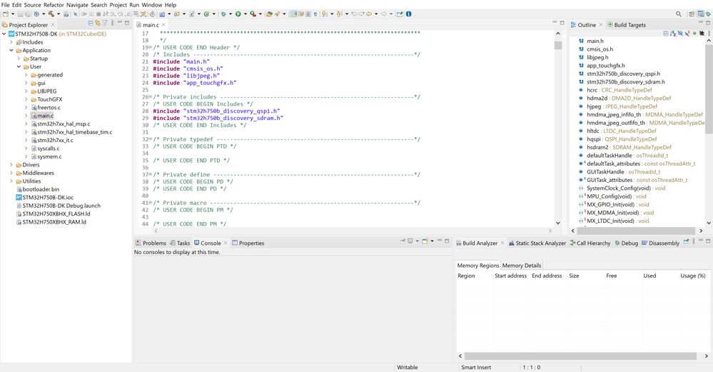

Hi @iTTy
My question is when once you change something in BL program, how do you build it and flash it.
In the below image i have marked the "main.c" of the bootloader. The same open project contains the application main file as well which is the file usually built and programed. A pre complied binary of the bootloader is already given, but I want to rebuild the bootloader program and generate the new binary file

2024-02-07 2:11 AM - edited 2024-02-07 2:11 AM
Oh I see, I apologize for my confusion.
Bootloaders are usually handled as separate projects from the application. If you have the IAR Embedded Workbench, then there is already a project ready to be worked on. If you don't have IAR, then you need to create an STM32CubeIDE project and add the files in the gcc, Inc and Src folders and then use the Makefile to generate the .bin file.
I don't think you can develop both Bootloader and Application under one project, at least I don't know about it.
