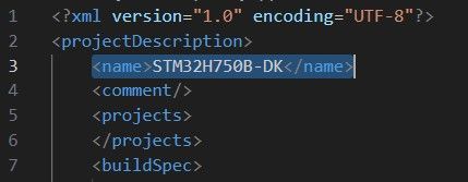

Hello @JNova.0 ,
Yes, you are right. Unfortunately, the name of your TouchGFX project does not reflect in the STM32CubeIDE project.
Thank you so much for pointing out this issue, we will try to fix it as soon as possible. Meanwhile, you can just simply change the name of the STM32CubeIDE project (.project file), by opening it in an text editor and changing the name to your preferred one. Or, you can just open your project in a new workspace.
Project name in STM32CubeIDE .project file
Thank you again for your help
