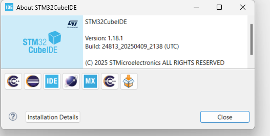

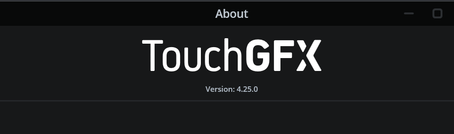

Here are my application versions.

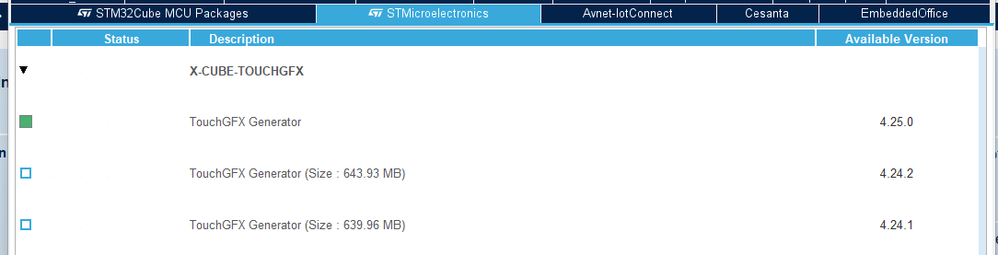

STM32CubeProgrammer
TouchGFX (last one)
In CubeMx, I add the TouchFX Generator

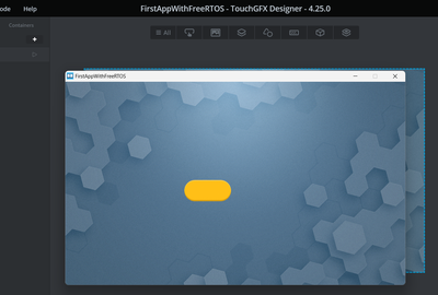

In TouchGFX Designer, I can simulate my application
Unfortunately, in the CubeIDE step When I compile the project and upload the compiled application, nothing happens on the display (blank screen).

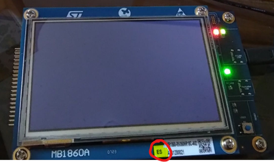

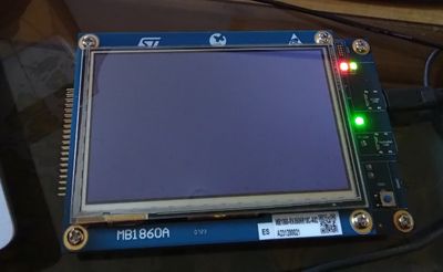

I am facing the same issue on 2 out 10 STM32U5G9J-DK2 Boards I have bought 5 months ago. How can I check out the board version (ES Version or official version)? Is there any indication referring to the board version?
2025-09-29 1:49 AM - edited 2025-09-29 1:49 AM
Normally our ES have this label printed and sticked on the board itself, like on the shared picture. Have you bought your boards (including the ES boards) from our store or from another supplier?
2025-09-30 2:42 AM
Thanks for the prompt reply!
I have purchased the boards from Mouser. According to your feedback, the boards do not belong to the ES category. Let me restart all the tests. I'll come later back to you. Maybe there is another issue I am overseeing..
