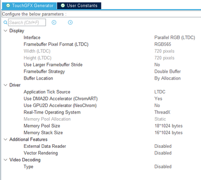

Screen size is 720 * 720 pixels and frame buffer strategy is "double buffer by allocation". The MCU I'm using is STM32U5G9 and has 3 MiB of RAM, so 2 MiB are dedicated to graphics.
The following is the working configuration for your convenience. To enable NeoChrom, I set the "Use GPU2D Accelerator" option from "No" to "Yes".

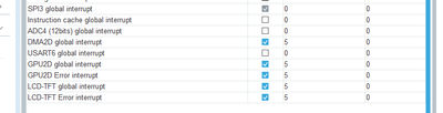

2025-05-05 2:01 AM
Make sure the GPU2D error interrupt is enabled as well, this is, somewhat counterintuitively, required for some operations.
2025-05-05 6:36 AM
I tried with no success. The following is my NVIC configuration
I also tried to enlarge the TouchGFX task's stack area, but nothing changed.
Do you have any other suggestion by any chance?
