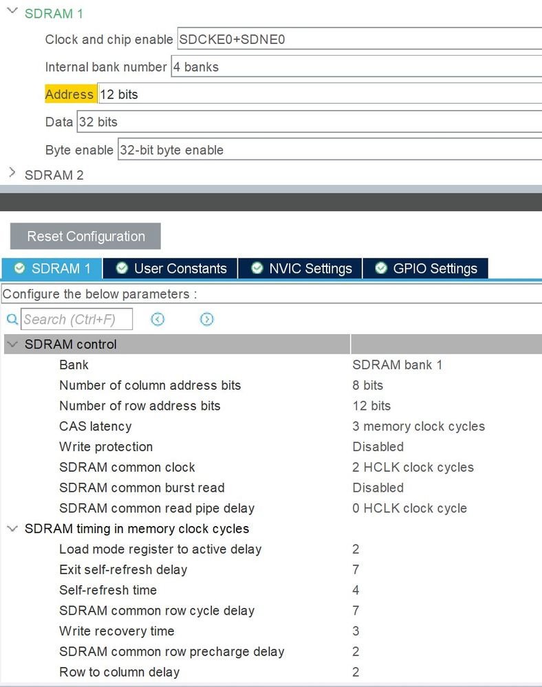

My FMC / SDRAM Settings:

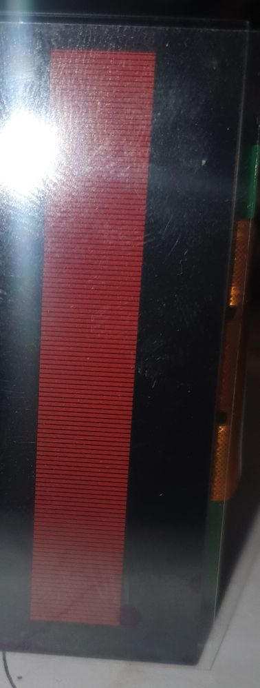

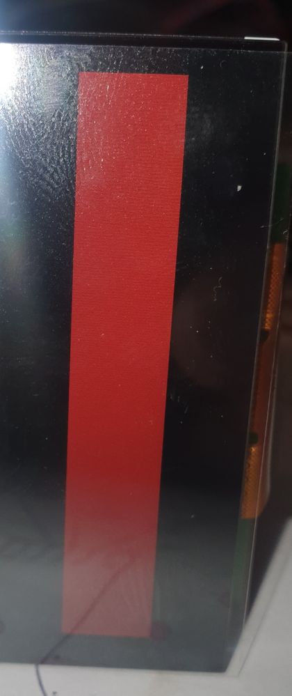

}Here are the SDRAM Settings in MX and the pictures of the display with and without SDRAM active.
What did i forget?

I changed Data and Byte endable to 16 bit instead of 32 and now it is working.

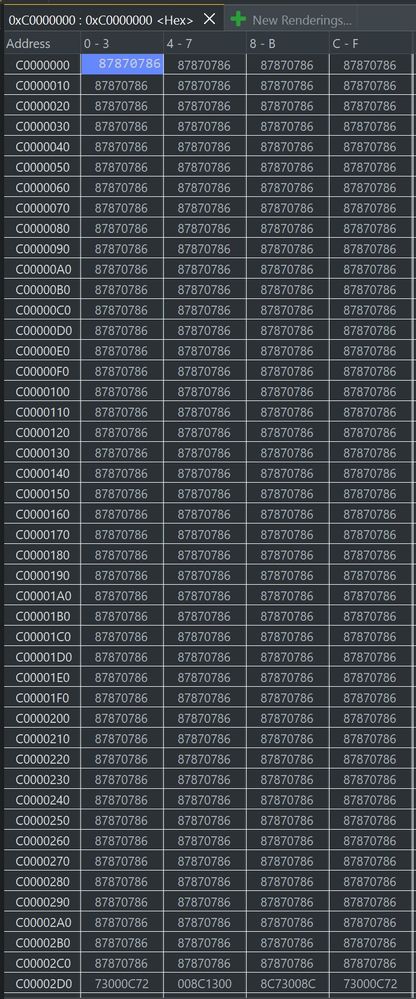

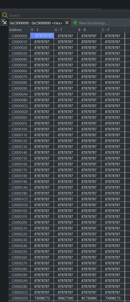

So i just found some time and i checked the 0xC0000000 just quick with the memory function in debug mode.
Am i right that the values should be the same one, if 32Bit or 16Bit?
Then there is a difference and something is wrong.
I am not sure if all pins are 100% connected from MCU to the SDRAM.
Does that look like it could be wiring issue or is it a setting problem?
The only change i did is the "Data" and "Byte enable" from 16 Bit to 32 Bit in CubeMX.
