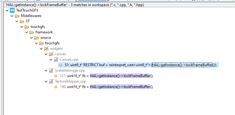

I have searched HAL::getInstance()->lockFrameBuffer(), but I don't see any call to this function:

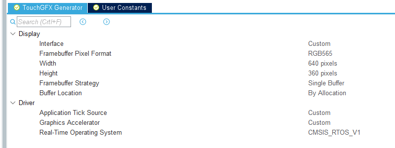

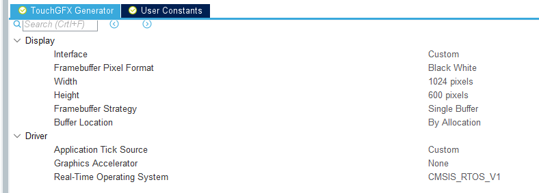

I have a news. I have changed the TouchGFX setting from this:
to this:
With this new setting I hit the breakpoint in the TouchGFXHAL::flushFrameBuffer(const touchgfx::Rect& rect) method.
I can't see the correct screen on the display, I think that i need to modify the display setting in appropriate way (horizontal back porch, horizontal front porch etc..) for see something.
