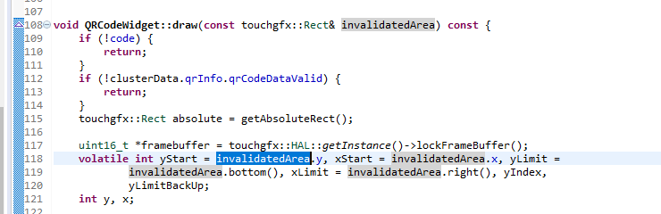

Hello, I am using customized widget in my project. I get buffer index using below:
*framebuffer = touchgfx::HAL::getInstance()->lockFrameBuffer();
In this customized widget, I want to set few pixels alpha value as 0 so it can be transparent and back ground can be visible.
Any suggestions?
Thanks

2020-11-26 5:29 AM
@Martin KJELDSEN Sorry I didn't get it. How should I set alpha value ? I am setting value of pixel as below image for custom widget.
Thanks
2020-11-26 5:54 AM
I think you should read some general material on how to modify pixels, like blending and applying alpha values. You're doing it in the right place, TouchGFX wise.
/Martin
2020-11-26 6:02 AM
@Martin KJELDSEN Can you please share links ?
2020-11-26 6:06 AM
There's lots of information online, just do some searching. It's pretty standard - Basically you seperate the red, green and blue values from the pixel and apply your alpha, then combine the values.,
