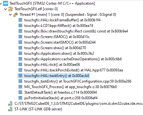

Yes i try to debugging! But is not simple to follow the code.
This is the call stack of the application when i pause it:
2020-06-22 7:15 AM
This is a 1bpp application? (LCD1).
Looks like its blocked trying to take a lock the farmebuffer.
