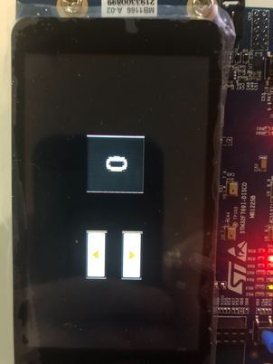

I see artifacts - stripes on both sides of pictures
Artifacts a dissapear when I use 16 bit SDRAM mode. Artifacts are disappear then I use RBG565
But I want 32-bit SDRAM and RGB888

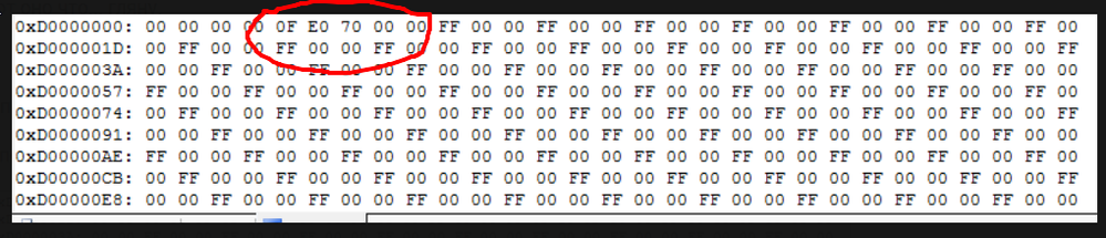

What can I see in memory, when I try to fill by color 0x0000FF
First bytes are broken
