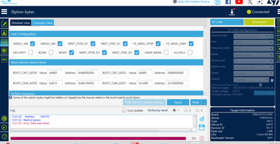

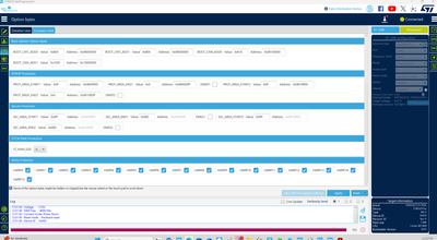

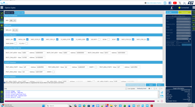

3. Make sure Option Bytes are correct – especially the Read-Out protection and Write protection settings.
--> Attached below 2 images for the settings.
