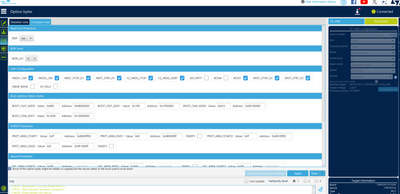

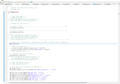

Hello @MM..1 ,
Thanks for quick reply, Yes there could be some trouble. Just for some more information. here are the OB settng from my cubeprogrammer and the Main.c function, this might give some more clue.
After power cycle, at least the debug log "MX_USART1_UART_Init" at line 207, should be received. I am not able to receive it as well.

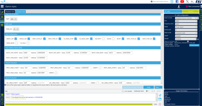

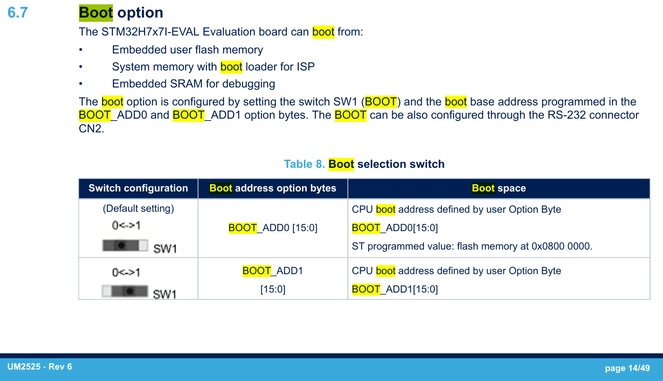

I extend my point 1. BOOT OB and state of BOOTx pins on PCB in reset ... Too boards with displays require more current sometime more as USB from PC give...
2025-12-06 4:34 AM
Ok Is the image shared looks good for the Boot ?
I can see only the BOOT_CM7_ADD0 Value 0x800 Address 0x08000000 and other parameters.
Hope its fine.
Yes agreed, more current may require but here the problem doesnt look with the current, I hope there should be some trouble with power on start up or bootup or something which is not allowing to load and run properly.
If any idea or clue what to try out ?
Will do as suggested, If any file or screen shots are required, I can share to understand better.
