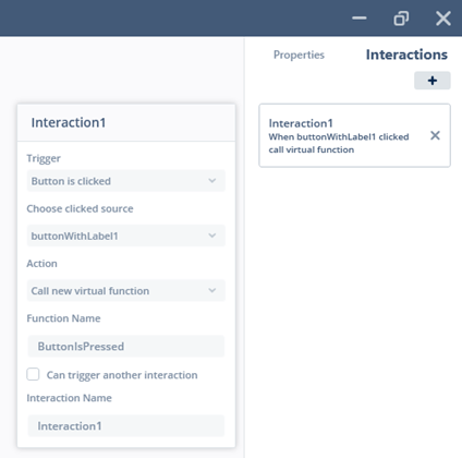

If you really want to use a LabelButton, you can do that easily using a Boolean variable and the "setBitmaps" method :
void ButtonIsPressed() override;bool toggle = false;void Screen1View::ButtonIsPressed()
