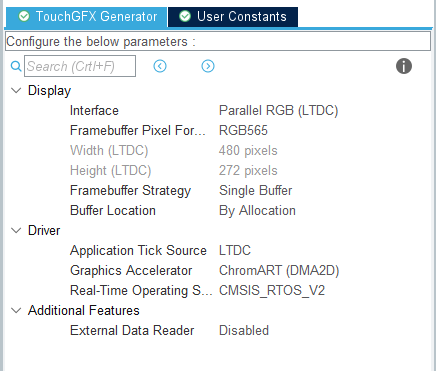

In the STM32CubeMX editor, a single buffer scheme is selected:

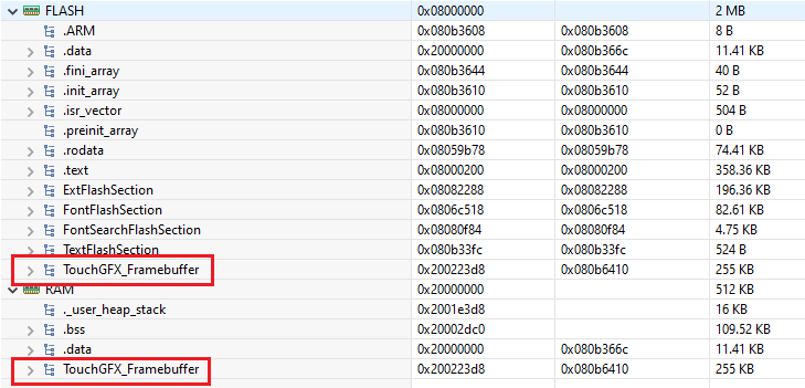

When the project is built without adding a "TouchGFX_Framebuffer" section to the linker files (xx_RAM.ld and xx_Flash.ld), the result is that the buffer is allocated in both RAM and Internal Flash:
Adding a "TouchGFX_Framebuffer" section to the linker files seems to have no effect at all:

You buffer falls in "initialized variables" category and during startup firmware copies it (default value) from flash to ram. Make it "uninitialized variable".
