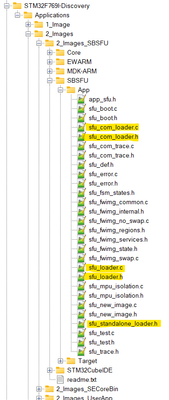

At SBSFU (local loader) :

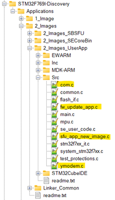

Or at UserApp level:
Or at the « standalone loader » level when it is used :
