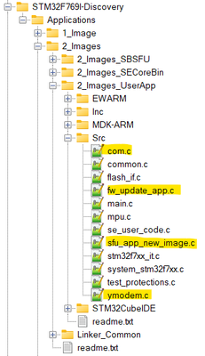

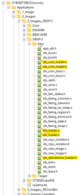

Here are the files which may be impacted in order to change from UART to CAN:
At SBSFU (local loader) :
Or at UserApp level:
Or at the « standalone loader » level when it is used :
