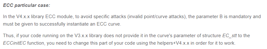

Hi @KMahe.1 ,
Please refer to the wiki article Security:Migration from previous Cryptographic Library version.
In this article, we precise:
Does this answer your question?
-Amel
2023-04-03 9:36 PM
Hi @Amel NASRI ,
