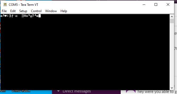

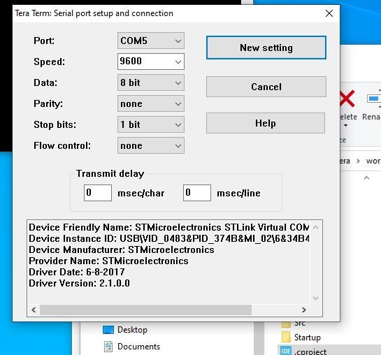

The hands on asks to connect a terminal to the board in order to receive some output from the app running on a Nucleo G071RB board. I am not, however, able to see any output, any ideas as to why that is? My Tera term configuration is given below, thanks! Upon reset I just get garbage printed to the screen as depicted in the 3rd screen shot below

Probably baudrate mismatch.
Try other baudrates in TeraTerm.
Observe the UART's Tx signal using oscilloscope/logic analyzer.
Review the clocks setting in STM32 (read out and check relevant RCC registers' content) and also check the given UART's baudrate setting.
