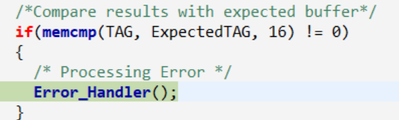

2025-03-21 3:59 AM
2025-03-21 4:46 PM
Hi @SafeDev
So sorry again, seems I missed some modifications in the last main.c file. Attached the correct one.
This time I did the full test as you see the snapshot below. We need 0-padding of both PlainText and CipherText arrays during both encryption and decryption. Otherwise, the last word of the PT and CT streams will be different from the provided NIST vectors. The added "0" will be ignored by passing the correct size in bytes of PT and CT.
Below the modified PT/CT streams with padding and Attached the new main.c file.
I will ask internally to either update the CRYP drivers API or give clear guidelines to show how to handle inputs that are not multiple of 32-bits.
