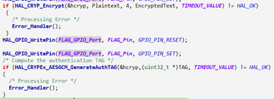

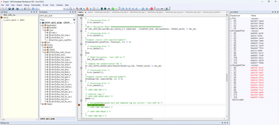

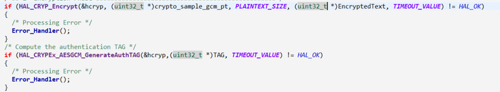

First of all this is my running code

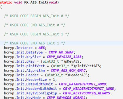

In order to be compliant with your example I have to change a little bit my AES configuration (Key is downgrade to 128 bit, No byte swap, DataWidthUnit set to word and HeaderWidthUnit set to word).
With these parameters I could obtain same cyphertext as yours
but again different TAG
TAG computed by STM32U585

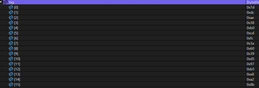

TAG computed by Visual Studio code

In the MX_AES_Init(void) function, in the field HeaderSize you put :
hcryp.Init.HeaderSize = 1;
It should be
hcryp.Init.HeaderSize = 4;
As the the expected tag is computed whith size 4
Can you check again ?
Best regards
2025-03-11 3:21 AM
Hi CMYL,
little better.
Now computed TAG match with the example one.

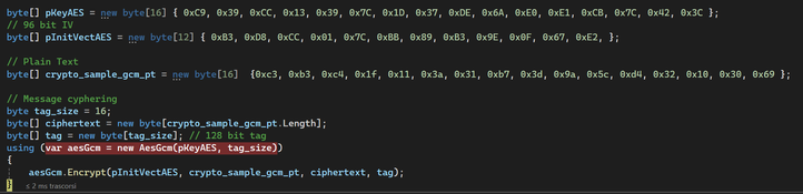

Unfortunately it still not match with the Visual Studio generated one.
This is the very simple Visual Studio code
As said before I have match between STM32U585 crypted text and Visual Studio crypted text. But tag results are different. (Visual Studio Tag is shown in the previous post)
