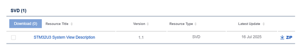

You can find the svd file in CAD Resources.

We were able to download the SVD file from the given link. Thanks for that.
As for the PKA peripheral , we needed the RSA feature, so have proceeded with wolfcrypt for now. Thanks for the support.
