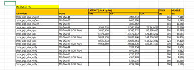

Please find below some measurement on H5 to give you idea about the performance gain for each configuration.
