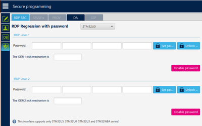

Especially the "Disable RDP regression with a password" action in the programmer GUI seems very counter-intuitive to do for an RDP2 level locked chip, as if you would deliberately brick it by disabling the regression (no password in level 2 = bricked). Is this always a safe step? Because as long as the level is 2, the password will be necessary to regress.

according to UM2237 the "Disable password" would indeed remove the OEM key. That does not brick the device, but it will burn the bridge and the device will be forever locked in RDP2. That's certainly something to avoid during development, but it's a valid product state when the product is deployed.

I know the flow between the RDP states, but the procedure in the STM32CubeProgrammer is a bit different from U5 I guess, and the steps are not that clear. What does "Disable password"' do for example? Its name suggest removing the OEM key, but wouldn't that brick the device? without that password you cannot unlock anymore.

For me, it is essential that the possibility exists to reprogram devices (refurbish) by unlocking using the OEM2KEY. In that sense it would become bricked when the programming PC would issue the erase password in this stage when it hasn't confirmed that the unlock was complete. It then becomes e-waste.
On the other hand, I understand that leaving the OEM2KEY unchanged does not pose any problems, after unlocking to RDP 0 it can always be changed to something else in case we will be using random OEM keys for each device. Unfortunately you cannot read the chip unique ID while in RDP2 to link the OEM2KEY to that, unless an existing application can tell you that before reprogramming.
