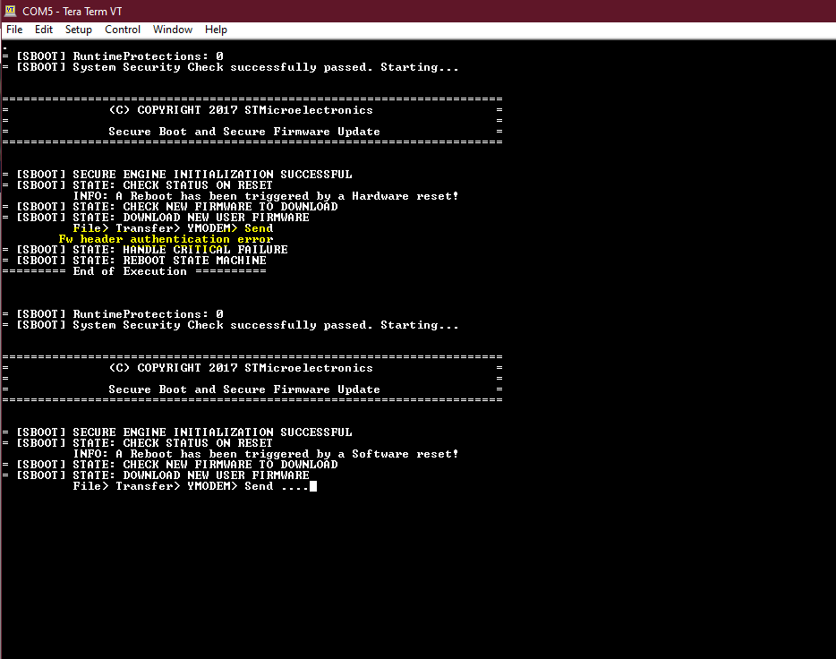

I am trying to run the Secure boot feature on STM32L433RC using the SBSFU library example project (single image slot). The example project I am modifying is STM32L432KC board.
Below are the modification/steps I made to example project to run on STM32L433RC:
Can anyone help me to successfully load the User app onto the board? Please let me know if I need to modify anything more or change the above modifcations.
Thanks!

Firmware header authentication error, means that during a local download procedure, the header could not be authenticated successfully.
This error is reached only if the header stored in RAM is altered (otherwise the download is bypassed without triggering a critical failure).
I advise you to refer to this UM2262 User manual "Getting started with the X-CUBE-SBSFU STM32Cube Expansion Package", that lists the main error messages together with their explanation.

Hi Imen,
Thanks for the reference. Moreover, I would like to confirm that is there any step I am missing while modifying the example project
(STM32L432KC) to flash it on other board (STM32L433RC)? Above is the error I am getting after I followed the steps from integration guide AN5056.
