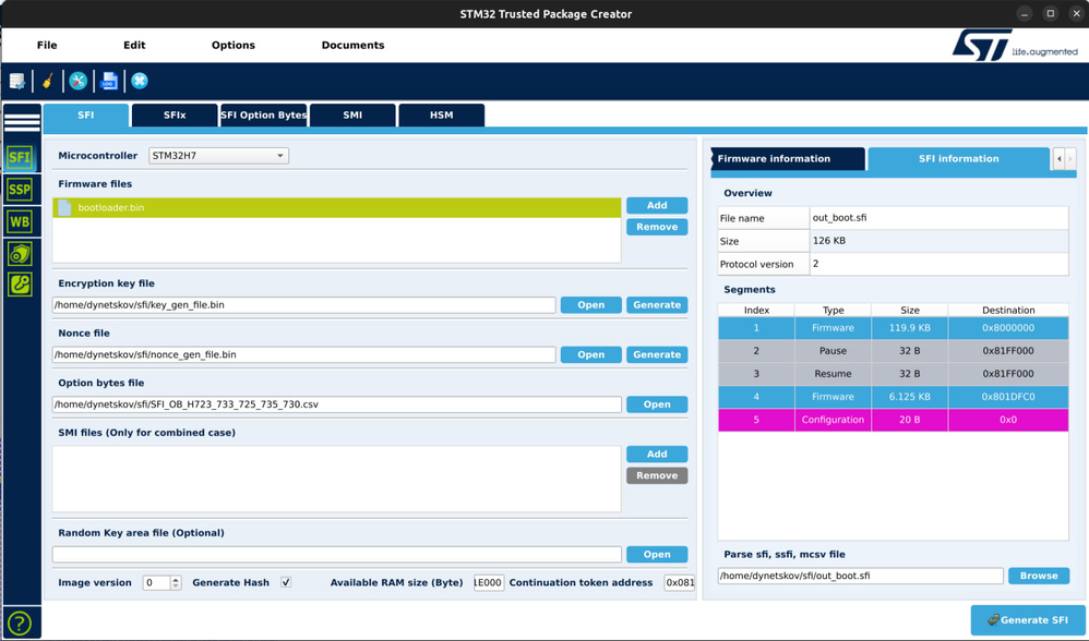

SFi creation:

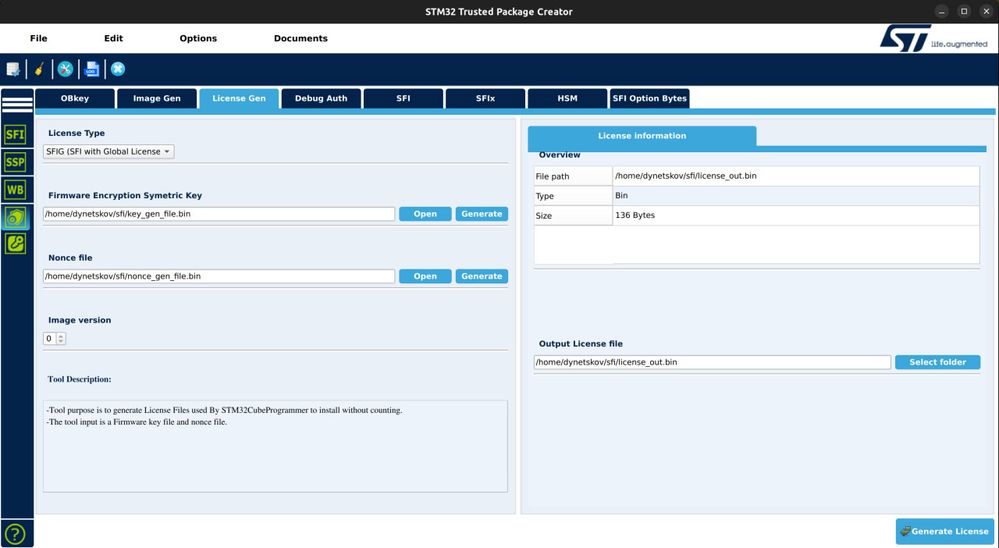

License generation:

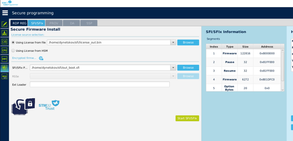

STM32CubeProgrammer SFI tab:

Hello @dynetskov ,
The global license does not apply to this product.
You need to use the STM32 HSMV2  to generate the license.
Please check wiki and X-CUBE-SFI
Best regards
Jocelyn

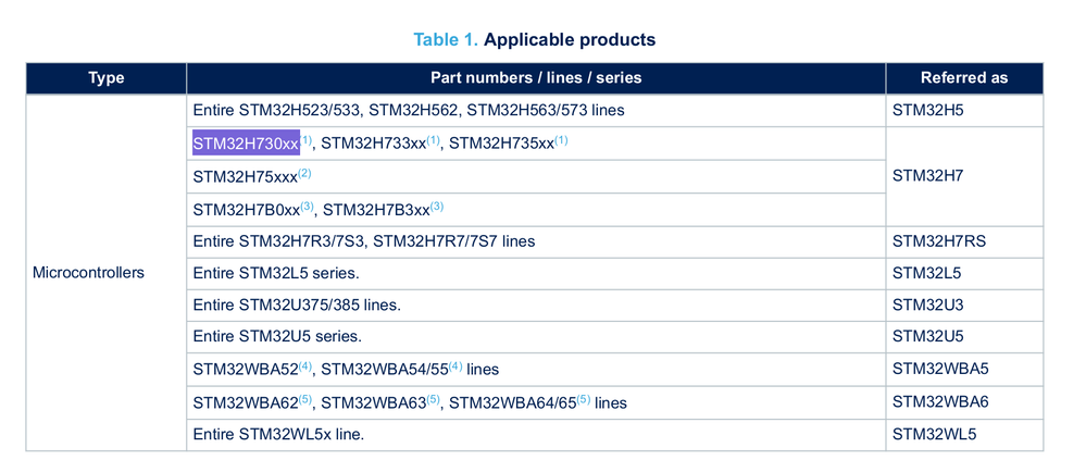

SMT32H730 is listed as supported product for SFI in AN4992
The full chip name is STM32H730IBT6Q
