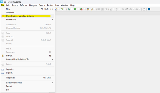

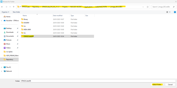

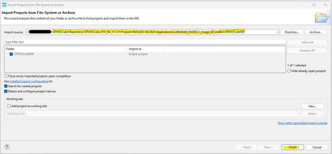

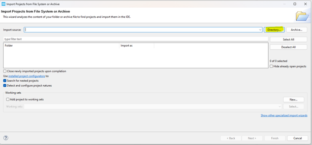

For example to open 1_Image_SECoreBin example, could you please follow these steps:
1- Click on File>open projects from File System
2- Click on Directory
3. Choose the path of 1_Image_SECoreBin example then click on Select Folder
4- Click on Finish

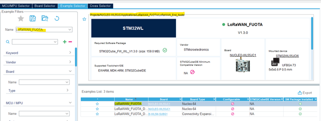

The LoRAWAN_FUOTA example in the Example Selector corresponding to LoraWAN_End_Node under Projects/Nucleo-WL55JC/Applications/LoRaWAN_FUOTA.
To build Projects/Nucleo-WL55JC/Applications/LoRaWAN_FUOTA/LoraWAN_End_Node example without error, you need to respect compiling order.

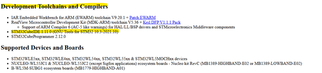

As mentioned in the release note of STM32Cube_FW_WL_V1.3.1 that the development toolchain of are:
For that, could try to download STM32CubeIDE 1.11.0 version and build the FUOTA example and let me know if the issue is solved or not?
To downlow old version of STM32CubeIDE toolchain, please click on this link and open a case to our support team.
I tested these two examples "\STM32Cube\Repository\STM32Cube_FW_WL_V1.3.1\Projects\NUCLEO-WL55JC\Applications\LoRaWAN_FUOTA" and "\STM32Cube\Repository\STM32Cube_FW_WL_V1.3.1\Projects\NUCLEO-WL55JC\Applications\LoRaWAN_FUOTA_DualCore" and I'm able to build them without issue using STM32CubeIDE1.11.0 version.

One thing I didn't mention; I created the projects via the Cube IDE examples selector:
File | New | STM32 Project >> Examples Selector | FUOTA...
This only gave me the option for using FW 1.3.0. I don't know how to install the 1.3.1 patch to the IDE.
4- Click on Finish
