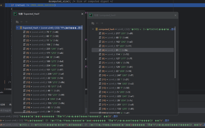

When TrustZone is enabled, X-CUBE-CRYPTOLIB produces incorrect SHA256 hash values.

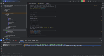

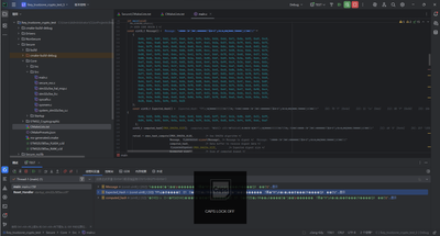

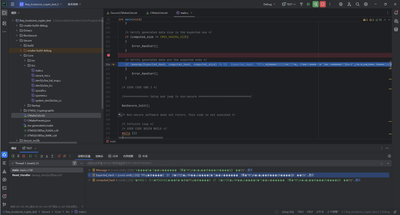

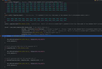

Thank you for your reply. I have published a minimal reproducible example on GitHub, using the latest version of X-CUBE-CRYPTOLIB, which is definitely obtained from ST.

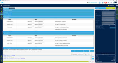

I have correctly enabled TrustZone (TZEN) according to the community's instructions.
The issue does not appear to be related to any other peripherals, so I only enabled ICACHE and GPIO to monitor the MCU's behavior.
However, it still doesn't work as expected — the SHA256 output is consistently incorrect, although the result remains the same on every run.
Apologies, but the minimal example does not use mbedtls because its behavior is consistent with X-CUBE-CRYPTOLIB, always producing the same incorrect value. If needed, I can upload an example that uses STM32-MW-MBEDTLS, which is maintained by ST.This is github link
https://github.com/linglitel/bad_value_with_trustzone_for_STM32u585
