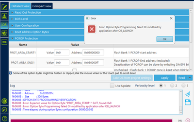

I have a certain STM32H7 that I can't erase sector 0 using STM32CubeProgrammer.
I think it is because PROT_AREA_START1 and PROT_AREA_END1 are not correct. I am trying to get back to default values of
PROT_AREA_START1 =0xFF (0x0800ff00)
PROT_AREA_END1 = 0x00 (0x080000ff) to disable the protection.
However I cant Actually change the option bytes through the programmer. I get:
an error: "Expected Value for option byteP: "PROT_AREA_START!: 0xFF, fount 0x00"
RDP is level 0 (AA)
I am using ST-link. Thanks for any help,
Trevor

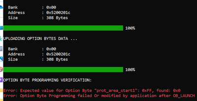

2025-01-23 2:34 AM - edited 2025-01-23 2:37 AM
I am Facing Problem please suggest Some solution
i attached Batch Script running for changing option bytes and stm32cubeprogrammer.
