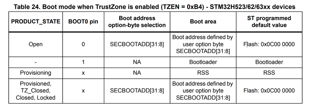

Can you share the log of bootloader operation which was done successfully as the address you are using is not the default address of flash when TZ enabled. See Table 24 of R0481:

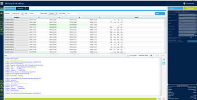

I'm able to download the nonsecure code using stlink as you are trying to do in the same address here is a screenshot:
Maybe share the Hex file that you are trying to download and make sure that all other OB are in their default state.
Regards
