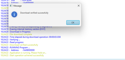

Can you make a light version of this programmer?
It takes more seconds to open the software.
We need basic programming tool for instant programming for some older stm series like stm32f0.
Pop up messages after programmings are annoying and can not be disabled.
The popup screens needs be clicked "OK button" 3 times individiaully on every programming cycle!!!
(We can see what is happening on the console too)
Please consider when o the new update
(I know CLI usage but for technician and other workers it is hard to arrange this usages)
As simple as possible we need, just select file and click program (Actually we dont no need to connect MCU for just programming)

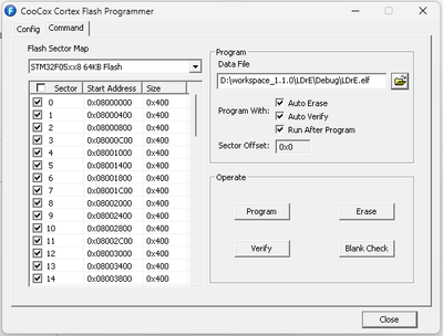

Thank you for the answer Pavel.
I mean I need simple GUI from ST side (without connect issues and without pop-up messages)
For example the software below is very efficiently used (still we are using for F0 series, but not supports G0 series)
There is no need to connect or etc buttons. Just click "Program" button and does everything quietly.
Regards,
Murat
2024-07-25 4:10 AM - edited 2024-07-25 4:14 AM
Of course, ST folks are very capable and this isn't a challenge for them. But afraid they are a bit busy to deliver this in reasonable time. Not mentioning summer vacations.
For older STM32s such as F0 you can try the ST-Link utlity https://www.st.com/en/development-tools/stsw-link004.html
It is not supported and does not know newer STM32s but should work for F0. It still runs on Windows 11. Maybe will run also on Linux with Wine.

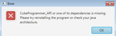

2024-11-20 10:09 PM
Please check the STM32CubeProgrammer Installer. i cant install it, pop up a message Java Runtime is missed or corrupted, i have both computer and in both is the same error, the last i did was upgrade windows.
2024-11-24 2:38 AM
Hi, Nawres
I have downloaded SetupSTM32CubeProgrammer_win64 from your website.
It works fine on Win 10 64 bits OS laptop with no issue after installation.
However, when I am trying to install it on Win 7 64 bits OS laptop, it appears the following error.
I have checked Java Architecture on Win 7 64 bits OS, it is Java 8 update 431 (64-bits). Could I know what I could do to solve this issue? After doing some research on forum, it looks like this is a known issue during old version of STM32CubeProgrammer.
Meanwhile, after encounter the above issue, I have tried to uninstall both SetupSTM32CubeProgrammer_win64 and Java 8 update 431 (64-bits).
I have also trying to download SetupSTM32CubeProgrammer_win32 and Java 8 update 431 (32-bits), but the same error message is pop up on the same laptop.
Look forward to your input. Thanks!
Kevin Xu
2024-11-24 4:28 AM
Windows 7 is not a supported OS for recent CubeProgrammer updates. Try older versions.
