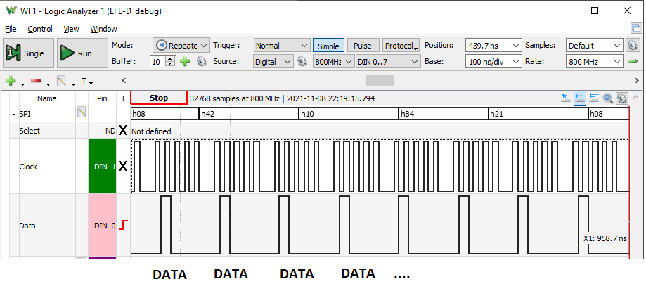

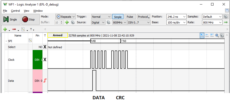

I'm struggling with the implementation of continuous SPI data transfer in Transmit only master mode with DMA in circular mode and enabled CRC calculation.
In any other configuration I've tried (DMA normal mode or SPI transfer with MCU polling) is CRC correctly added after data except after each data frame (5 bits) except circular mode.
In this case is CRC never generated and on physical SPI layer there is continuously transferring only data packet.
I can see that DMA transfer in circular mode is running correctly as data packet corresponds to continuously changing source data.

SPI communication with DMA in normal mode {CRC is added)

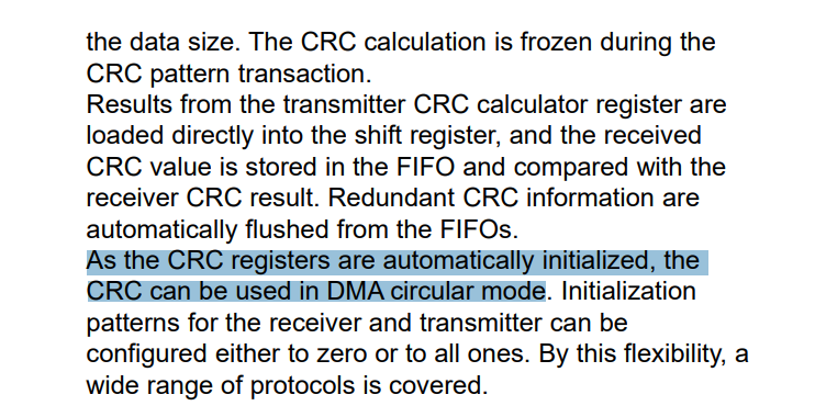

STM presentation to the STM32H7 SPI says that combination of DMA circular mode and CRC should be possible LINK

For debugging purpose I'm using standard HAL_SPI_Transmit_DMA function pointed to the GPIO register
HAL_SPI_Transmit_DMA(&hspi1, &GPIOC->IDR, 1);SPI1 peripheral initialization function snippet

I have the same issue as well, STM32H7 using SPI with circular DMA and attempting to use CRC associated with the SPI peripheral.
When diving into the HAL code I noticed this inside HAL_SPI_Transmit_DMA(), HAL_SPI_Receive_DMA() and HAL_SPI_TransmitReceive_DMA() within stm32h7xx_hal_spi.c
/* Set the number of data at current transfer */
if (hspi->hdmatx->Init.Mode == DMA_CIRCULAR)
MODIFY_REG(hspi->Instance->CR2, SPI_CR2_TSIZE, 0UL);
else
MODIFY_REG(hspi->Instance->CR2, SPI_CR2_TSIZE, Size);
If TSIZE is 0 the CRC will not be calculated. So it looks like ST have disabled the ability to use circular DMA + SPI + CRC
