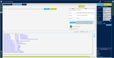

But no luck. Once the Provisioning state is set, I can't provide the *.obk file using the PROV dropdown.
Product state is 0x17 as correctly expected:
So both behaviours are equals using directly HALs drivers or STM32CubeProgrammer.
