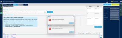

But no luck. Once the Provisioning state is set, I can't provide the *.obk file using the PROV dropdown.

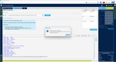

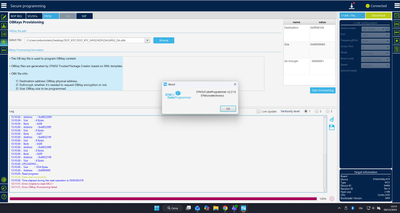

2025-12-09 4:12 AM - edited 2025-12-09 4:15 AM
Hi @Jocelyn RICARD,
Also in hotplug mode I'm not able to provide the OBKey:
The STM32CubeProgrammer is the last downloadable:

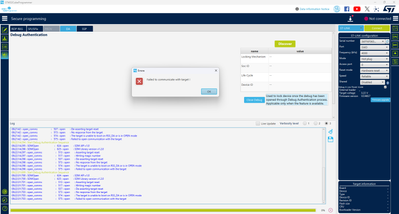

2025-12-11 10:59 AM
Hello @MattiaB ,
Now you are in provisioning state, just disconnect cube programmer and use DA tab.
You will be able to launch the discover.
Cryptosystems : STPassword
In the log you should get ST provisioning integrity status: 0xeaeaeaea.
Just select your password.bin file generated by TrustedPackageCreator and request FullRegression.

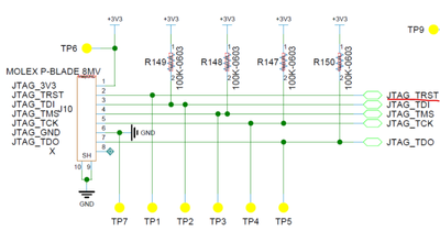

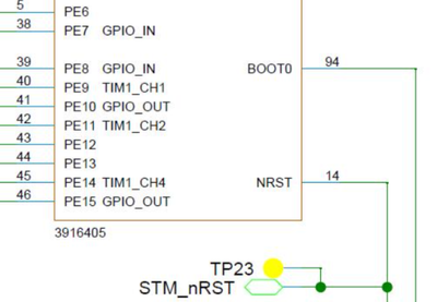

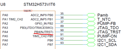

2025-12-12 2:12 AM
Hi @Jocelyn RICARD,
if you mean the NJTRST it's connected to the STMLink probe as follows:
If you mean NRST, it is NOT connected to the STLink probe:
Let me know if it's correct.
2025-12-12 3:03 AM
Hello @MattiaB ,
I confirm that you need to control the NRST pin to make Debug Authentication work
Best regards
Jocelyn
