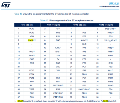

To resolve this issue, ensure the board is properly powered and verify the boot configuration settings (BOOT0 and BOOT1 pins). Make sure they are correctly set for USB bootloader mode.

Thank You for your response. When using OEMiROT, the system bootloader is activated by software (OEMiROT) - jumping to the address of the system bootloader. The system bootloader activation method You mentioned refers to a hardware initiation (BOOT0 and BOOT1 pins).
