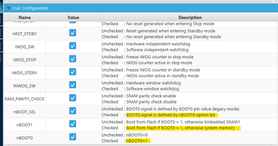

Note: I found that the default option byte setting does not use Boot0 but nBoot0, meaning it might not be possible to enter System memory using nBoot0?

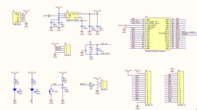

This is the schematic of the MCU I used for testing.

Since nBOOTSEL = nBOOT0 = 1, the chip will always boot to user flash and ignores the state of the BOOT0 pin.
Connecting NRST to the debugger would allow you to connect under reset, which would be another method to recover the chip.
