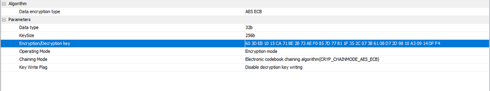

I activated the AES HW aceleration module to do the encryption/decryption there. I did not get CCM working but going even further I tried to replicate the example on the STM video tutorial on youtube:
Security Part3 - STM32 Security features - 25 - AES CRYPT lab (I cannot add the link directly).
This video tries to replicate one of the examples of the ECB encryption/decryption of the standard NIST Special Publication 800-38A. I am trying to replicate exactly the same example.
The function HAL_CRYP_Encrypt used in this video is not available in the version of the HAL drivers I am using (V.1.21.0) but i tried using the functions HAL_CRYP_AESECB_Encrypt and HAL_CRYPEx_AES. I even tried using the 32bits and the 8 bits configuration posibilities but none of them gave the expected result:

hcryp.Init.pKey = (uint8_t *)pKeyAES;
if (HAL_CRYP_Init(&hcryp) != HAL_OK)
_Error_Handler(__FILE__, __LINE__);
ret = HAL_CRYP_AESECB_Encrypt(&hcryp, plaintext, 16, encryptedData, 1000);
