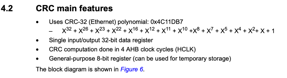

I've been implementing I2C communication between F401CCU6 and Nucleo F746ZG, while adding CRC I got different outputs, Nucleo provides configurable CRC peripheral, while F401 is by default set to 0x4C11DB7 (https://www.st.com/resource/en/reference_manual/rm0368-stm32f401xbc-and-stm32f401xde-advanced-armbased-32bit-mcus-stmicroelectronics.pdf#page=68&zoom=100,89,116)It also provides reseting initial value to 0xFFFF FFFF, ("The CRC calculator can be reset to 0xFFFF FFFF with the RESET control bit in the CRC_CR register. This operation does not affect the contents of the CRC_IDR register")

I've been testing it that way:
uint8_t test_crc[] = "12345";
uint32_t crc_val = HAL_CRC_Calculate(&hcrc, (uint32_t*)test_crc, sizeof(test_crc)-1);Nucleo spits out 0xBD9AB747 as it should be according to crccalc, the point is, if F4 polynomial is 0x4C11DB7 as stated in manual, and init value was reset to 0xFFFF FFFF accordingly, then why the result is different (0x5355ffb1)?

So, for example:
uint8_t test_crc[] = "1234";
uint32_t crc_val = HAL_CRC_Calculate(&hcrc, (uint32_t*)test_crc, 1);Should be working? Are these 4 bytes making one 32 bit word?
What would be the proper implementation of calculating CRC of any uint8_t array?
