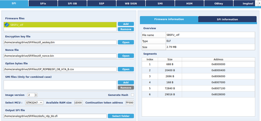

SFI creation :
onFull logs:
./STM32_Programmer_CLI -c port=swd mode=HOTPLUG -sfi protocol=static /home/analog/drive/SFIFiles/sbsfu_rdp_bb.sfi hsm=1 slot=1
