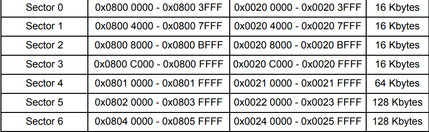

I'm using a STM32F722RE and in my current application, I used sector 2 and 3 of the flash as a virtual EEPROM. The memory of the controller looks like this:
So sector 4 should be enough for the SBSFU and I would like to set my application to sector 5 and the download area to sector 6. Now, when I change everything in the linkerscript, the controller goes somewhere unexpected and I lose the debug connection,

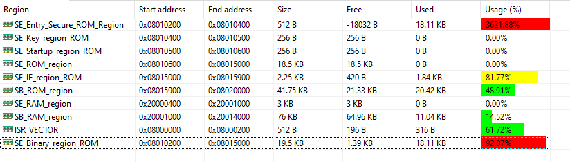

From my testing, always when I choose another start address for the SBSFU than 0x8000000, the update process over tera term fails and the SBSFU firmware gets bricked. The thing is, the SBSFU boots correctly before I flash the first time the application.
I also tried to split as follows, but this leads to the same error:

I also have trouble here, when I set the vector table to 0x08000000 and the rest of the SBSFU to 0x08010000. I can start a firmware update over UART, but the SBSFU crashed after the start and is then permanently destroyed until I erase and reprogram it. Might there be a problem with the MPU set in the example projects?
