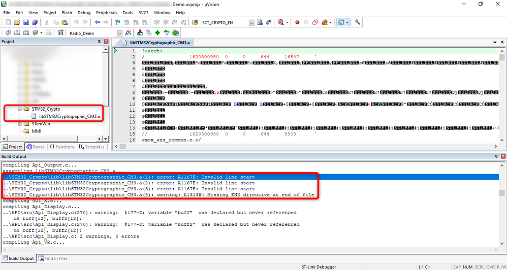

We had a project built using ST Crypto V2.0.6 (M3_CryptoHW_2_0_6.lib) library in Keil IDE. Now we replaced the ST Crypto library by V4.0.1 (libSTM32Cryptographic_CM3.a)
We are seeing the following errors
..\STM32_Crypto\lib\libSTM32Cryptographic_CM3.a(1): error: A1167E: Invalid line start
..\STM32_Crypto\lib\libSTM32Cryptographic_CM3.a(2): error: A1167E: Invalid line start
..\STM32_Crypto\lib\libSTM32Cryptographic_CM3.a(3): error: A1167E: Invalid line start
Attached is the screen shot of the project.
Let us know the procedure to update the library and if any workarounds are present.

Hello @Shreevatsa Y
I'm not sure where your issue comes from.
Can you try compiling one example provided for cortex M3 in
STM32CubeExpansion_Crypto_V4.0.1\Projects\NUCLEO-L152RE\
On my side, with Keil 5.33 this is compiling without issue.
Best regards
Jocelyn
2022-01-04 3:26 PM
You're trying to assemble a library. Read the Keil documentation.
2022-01-05 7:38 AM
Hi @Shreevatsa Y ,
Besides to proposals from @alister and @Jocelyn RICARD , I suggest you to refer to the wiki article Migration from previous Cryptographic Library version. I hope you will find required help there.
