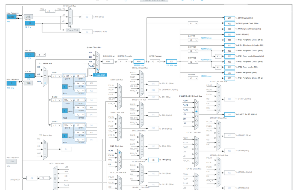

2021-02-03 1:13 AM
Hello Imen,
I'm currently debugging the problem. The RNGEN isn't set. Even writing directly to the register doesen't change any bits in it.
At the moment it "smells" like there is something wrong with the clock configuration. I attached a screenshot of the current clock configuration.

@MLang.7 ,
I found different code that you may want to check out, as your code is not properly implemented and you shouldn't update the HAL.
I see that you passed an empty handle (hrng) to the HAL_RNG_Init (& hrng) function ! So, what will you initialize in this case ?
I advise you to follow the HAL working examples and you may re-use sections available in the example or get inspired from them:
hrng.Instance = RNG;
//hrng.Init.ClockErrorDetection = RNG_CED_ENABLE;
if (HAL_RNG_Init(&hrng) != HAL_OK)
Error_Handler();
}Imen

2021-02-03 2:08 AM
In the example, there is one line:
/*## Configure the RNG peripheral #######################################*/
RngHandle.Instance = RNG;
/* DeInitialize the RNG peripheral */
if (HAL_RNG_DeInit(&RngHandle) != HAL_OK)
/* DeInitialization Error */
Error_Handler();
...which I missed copying and totally overread later. Thats the line where the handle is asserted. When missing, the driver doesen't notice the invalid handle.
